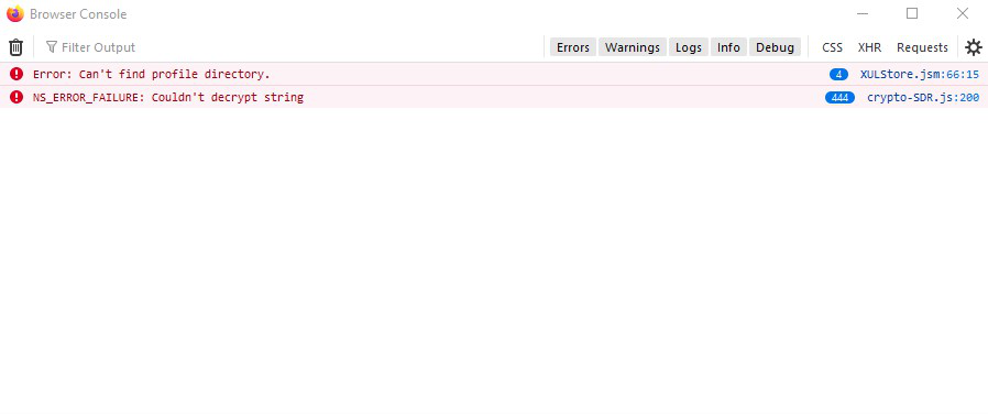

I took the steps for generating the error messages when opening Lockwise (image posted). Not exactly sure why it states it cannot the profile directory since it can find all of my book marks and everything else related to the profile.
That looks like a problem with the secret decoder ring (SDR). Not sure if this is about the master password or a problem with the key file and logins.json not matching.
I don't know how the troubleshoot or fix this and recover the passwords.
